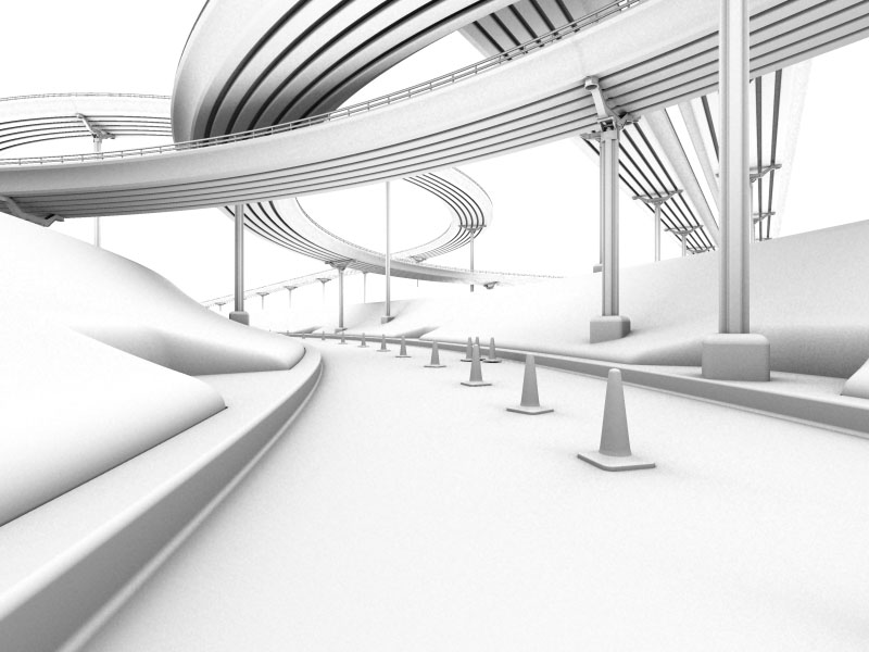

The AO Chris is talking about is a pass for faking GI. Basically, when rendering, from each sample point draw a hemisphere over it and randomly shoot some HSphere rays. If they hit something, they return dark. If they don't hit something, e.g. they escape to the environment or hit the max distance, they return bright. Average the darks and brights to get the shading.
So it's not based on actually bouncing any light, it just darkens a surface according to how much of its environment is "occluded" by other objects within a certain distance. It's really good at darkening the inside of your corners, if you have a radiosity render and you need to add a bit of "something", some kinds of dirt, some NPR techniques, but for our purposes when doing Vray renders it's easier, faster and looks better to do real GI instead.

Exactly as AJ tells you, but most people that use AO want you to think that it is in fact the light from the environment. Compared to true GI, it is far from it. I laugh when I read articles that claim they do GI via Ambient Occlusion. That is like saying I drive my car via ridding my bicycle. In order to be consider global illumination, the scene need to be illuminated by everything in the environment, including the scene itself. AO does not collect color, and does not bounce. Again, the GI method that is done is Vray is something that many places wish they had. That is why many mid to high end VFX places are switching to Max and Vray (or other GI rendering) just to have access to fast GI. The only thing that is stopping really big VFX shops is that their pipelines are so tied to their current system. It will take years for them to switch.... plus renderman has so much legacy, it will take years and years for it to adapt as well. Keep in mind that Renderman is a rendering engine that just got multi-threading this year.

One more thing.. Dirt is based on the AO thing. In the new Vray, there is a dirt shader. It is pretty cool because you can control distance, angle, falloff, even XYZ. Dirt is great.... Just don't confuse it for an actual lighting pass.
