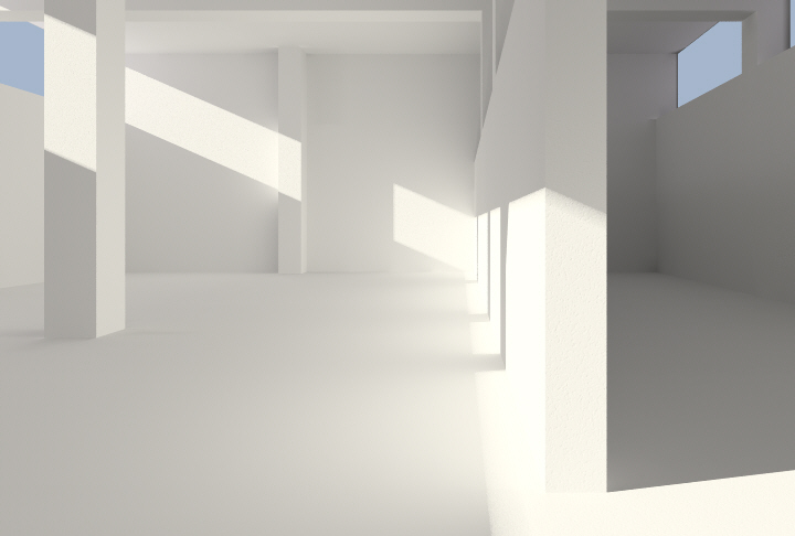

And here is the results with lightscape

hey Craig, what are the rendertimes with brazil and lightscape?

Brazil took about an hour over 2 dual athlon 2000+ machines but it was only so slow because I was rendering with lightscape and doing some heavy photoshop worl at the same time lol
Lightscape took about 20 minutes but remember the computer was under serious load

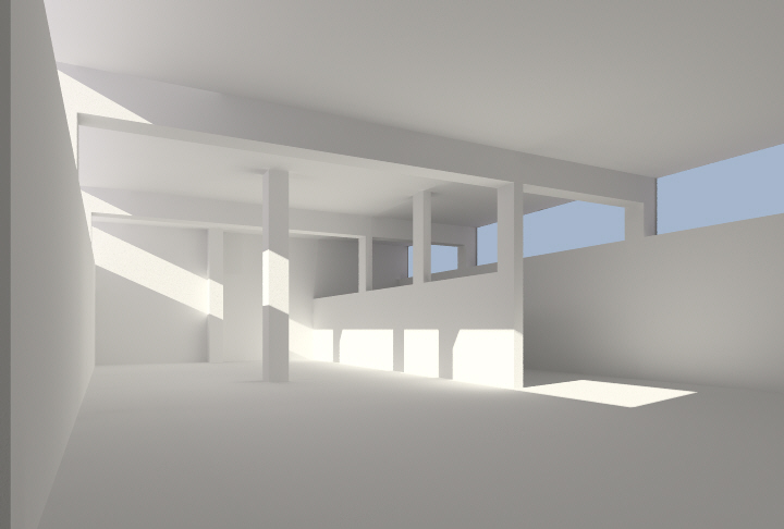

here we go...
3ds max 5.0
dual pentiumIII 1000, 512mb ram
1.2 minutes for radiosity calculation
10 seconds for rendering
10 minutes for radiosity calculation
12 seconds for rendering
10 minutes for radiosity calculation (same solution as before)
16 minutes for rendering (regathering with undersampling)
45 minutes for rendering (regathering)

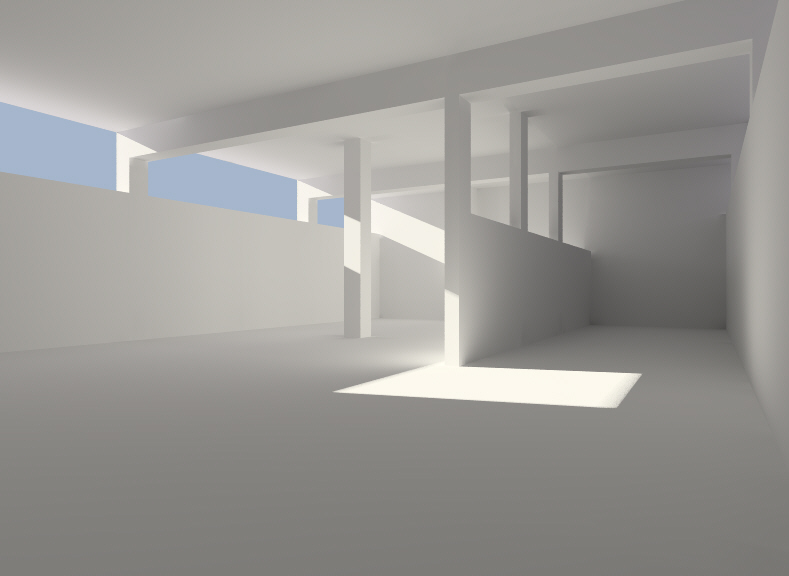

Viz 4, PIV, 1,4GHz, 512RAM calculation & rendering time: 14min. Remodeled in AutoCAD with solids.

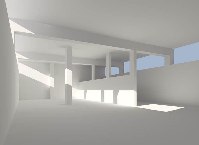

Lightscape with raytracing
settings to quality of 4 out of 5 on wizard, not much else with optimization, calc in background for about 12 mins on Ath 1G (also doing images in Photoshop)
you can see some artifacts around the post base because of the different sized polys causing meshing differences, and the raytracer makes for some harsh edges.

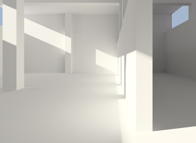

hi all,
here it is my first try....
p3 650 | 512mb ram
1- wizard level 1 (process: 2.5 mins | raytrace: <1 min)
result:
2- custom (process: 30 mins | raytrace: <1 min)
- face floor refined
result:
i think all the packages are doing a great job here, i am only curious about subdivision mesh size of your models....it would be great if you can post it.
i am thinking about adding some glass piece in the middle of this space (like a table or something)....why is that???....because i really love the glass material made by LS and i would like to see yours...what do you think?
lets refine the models now, doing it perfectly...
dont forget to post your parameters (it is really important)
